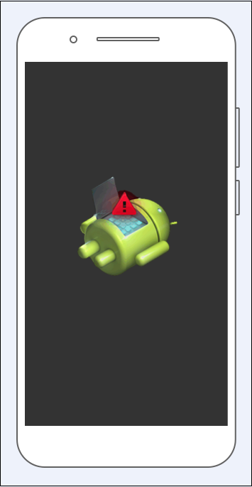

    4. Hold Power Button + Volume Up
    When the startup logo appears release the Power Button ONLY
    You will see the android logo appear as shown below
    Now release the Volume Up button

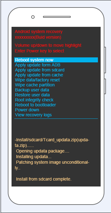

    5. Again, hold the Power Button for 2 seconds and then press Volume Up button
    WITHOUT RELEASING THE POWER BUTTON.
    You will see the interface below:

    6. Use Volume Down to navigate to Apply update from sdcard then press the Power Button to select
    7. You will enter a new interface as shown below.
    Use the Volume Down to navigate to Tcard_update_20160415 then select it with the Power Button

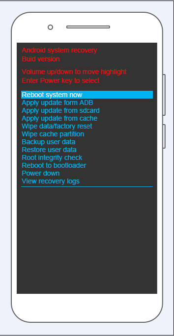

    8. The installation will begin and when it is done you will see the interfcae below. Select Reboot system now
